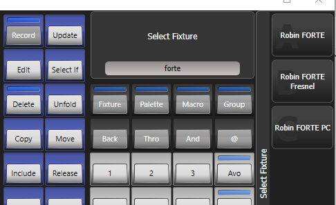

When you attempt to patch through the patch menu then it's recommended to use the search box - simply type 'Forte' when you are in the Fixture Type level:
Please note that the 'full name' is Robin Forte - thus, if you go through the menu with previous/next you need to go to Robin.

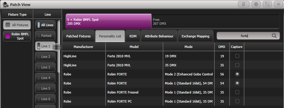

Even easier is the patch view: toggle to the 'Personality List' tab and type 'forte' into its designated search box:
