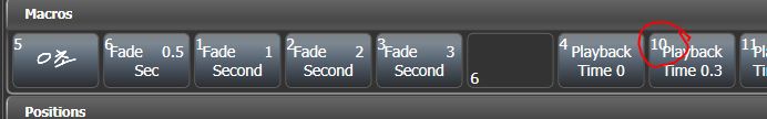

2. In Titan, I want to see "playback 0.3" macro source and "playback 0.3" macro id is "10" in red circle.
3. Go to Notepad and edit this sentence.
"<step>UserMacros.SetCurrentMacroFromUserNumber(1)</step>" => "<step>UserMacros.SetCurrentMacroFromUserNumber(10)</step>"

1. In Titan, delete "playback 0.3" macro which id's "10". They use same macro id so new macro doesn't show up.
2. Move "macro10.XML" to "C:\Program Files (x86)\Avolites\Titan\Macros"
3. Restart Titan and you will find "Macro 10" in "show library" window.
