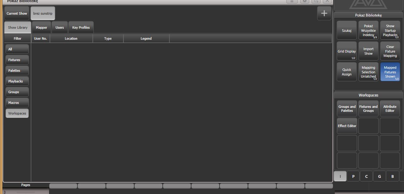

I've got different problem and im not sure if this is a bug.
Show library for current show works fine. I can see all the content, filter what i want and its ok.
But show library of imported show is incomplete. I cant see any playback, macro or workspace. I can see only few palettes and only normal palettes( and not all normal, just few)
What is strange that i think that other pallettes are stacked on these which i can see, like all the pictures where in the same place and not fully transparent letters (probably 0 of 1 etc)
I dont know what I am doing wrong, maybe there is something. Im working on Titan simulator right now, i havent check this on the console yet.
I attached a print screen.
show library.JPG (109.6 KiB) Viewed 23972 times

Does it make any difference if you switch to grid view?
nachwilunie
Posts: 9
Joined: 28 Aug 2017, 19:55
Re: Show Import
Postby nachwilunie » 23 Feb 2018, 11:15
no:(
