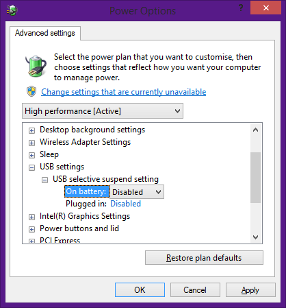

Make sure any Windows power saving functions are disabled, particularly any involving Usb.

I already do it, but still happen
