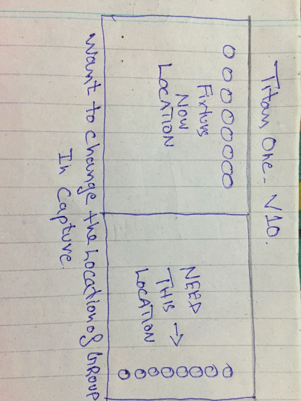

Normally when patch fixtures the capture shows all in front of back wall, how can change the group position to left or right sides of the stage ( I know solo one by one can be adjust )

With the wheels set to Visualiser and the group selected, toggle the Position attribute bank to show Rotate Y on the centre wheel and change the value to 90 or 270 degrees. Then toggle back to Position and change the X, Y and Z as required. Note that you can use Fan when changing Position to spread out your fixtures.
