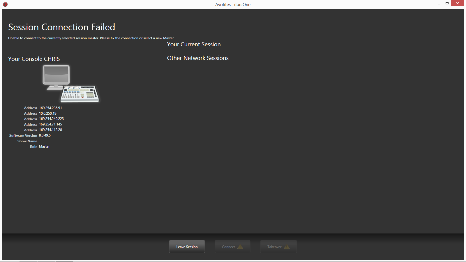

Just upgraded to v8 on my laptop, gone to boot t1 and after messing with the code stuff it sends me straight a connection session failed screen.....wont let me do anything else?
Anyone got any ideas?
connection session failed (t1)

Re: connection session failed (t1)
Any input on this?
Cant do a thing....
Cant do a thing....
- Attachments
- Screenshot (696).png (66.79 KiB) Viewed 9146 times
This screen will appear if the user interface loses connection to the Titan Engine, this is usually due to network issues when working in multi-user but can also occasionally happen when running on a single machine. If this happens on start up it could be due to an issue while loading the previous show file. The file can be found in Windows Explorer by typing %appdata%\Avolites\Titan in the address bar, alternatively browse to C:\Users\<username>\AppData\Roaming\Avolites\Titan replacing <username> with the name of your user account. The file to delete is called SHUTDOWN.d4b, once you have done so, please restart the software.
Thanks, it also needed me to give full control permission rights to the titan engine.
