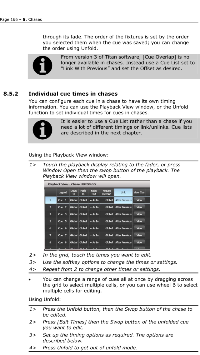

Titan mobile manual p166

Cue Overlap is a separate function to Fixture Overlap the former was replaced by the more powerful Link Offset in cue lists the latter is still available for both chases and cue lists.
