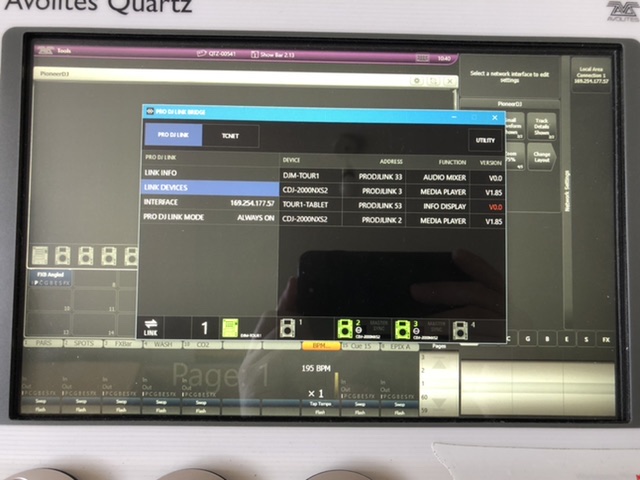

Having trouble trying to get Pro DJ Link to work.
Using a Quartz, I have the Bridge software running, and it shows my NXS2's and Tour1 in green.
But in the Titan software, there is nothing showing in the Pioneer Workspace window. Mixer, and Decks all grey.
What am I not doing correctly?

Anyone any ideas?
I’ve tried using a DHCP server on a local subnet for everything, and also direct from the tour to the Quartz, so it all gets a link local 169.254 Address.
Switched out of 13 down to 12.1 and back again.
I do notice that in the network and sharing Center, it lists the network as public on the quartz, but can’t change it to private as it’s locked down I think.

Managed to sort it.
It was the TCNET node that was set to SLAVE rather than MASTER.
