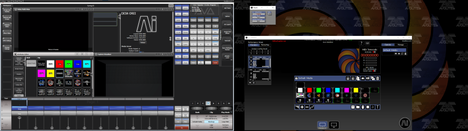

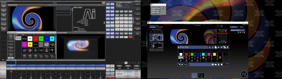

You can use Ai (the big one) in demo mode which requires only a standard AvoKey for this. As far as i know the demo watermark doesn't show in NDI and Synergy (pixelmap connection). This is my current test setup: Titan v15 and Ai v12 on one computer, licenced by one T1 (I am using Titan Simulator to get the number of universes). I have patched 800 RGB fixtures for this, giving a matrix of 50 x 8.
black content, no watermark
colorful content pixelmapped
