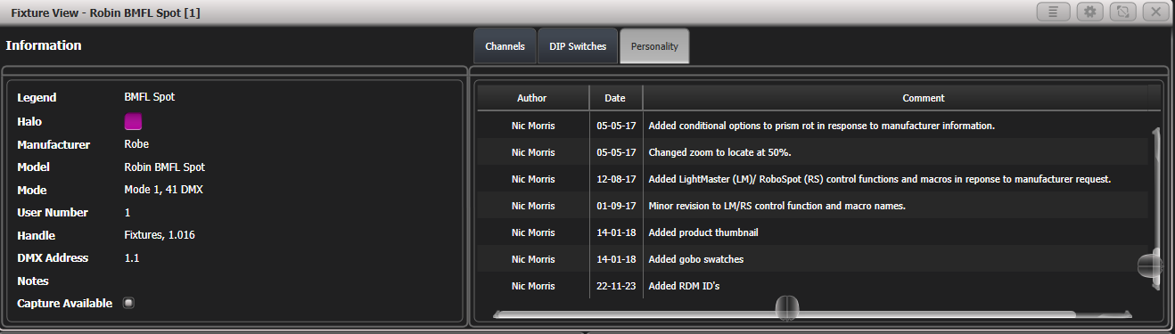

Can you please tell which fixtures these are? Also maybe you can tell which personality version it is - you find this via open/view and then click the button of one such fixture - this open the Fixture view. Then in the right pane slect the Personality tab and scroll all the way down - it should look similar to this:
I have the feeling that maybe it is a personality thing.
But it might also be a show thing - a playback which is hidden or a master. You would find this via the show library...
