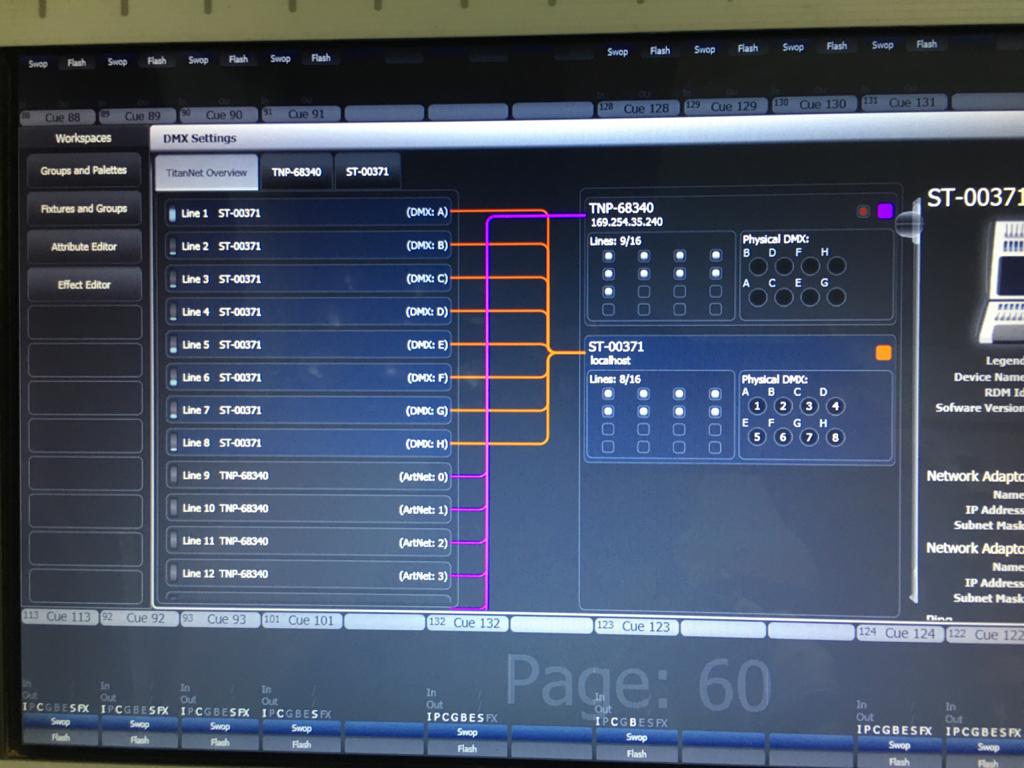

Hi , how can I assign my DMX lines to TNP physical , need help like tutorial video or some sort of documents.
Regards
TNP physical DMX

In the screenshot it appears that you have lines already assigned to the TNP but set to output Art-Net. To change how the lines are output from the TNP you should switch to the TNP tab at the top of the window, then the outputs whether tha be Art-Net or physical ports are assigned in the same way as you would do with a console (i.e. select the available node on the left and then tap the line you want to assign it to). There is more information of DMX assignment in the manual.
On a side note it appears that the serial number of the TNP has been set incorrectly, this might cause incompatibility especially if you end up with more than one TNP with the same serial number. When convenient to would be a good idea to run a recovery on the TNP and use the prompts during recovery to set the serial number correctly as it appears on the back of the unit.
