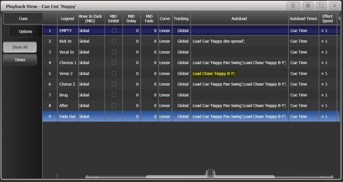

I'm creating a cue list and countered some problems with autoloading.
avo knipsel.PNG (82.78 KiB) Viewed 7012 times
I added the "Happy B-Y" playback afterwarts when the rest of the cue list was already created. This playback is a chase. It works in cue number 4, stops in cue 5 and cue 6 and continues in cue 8. I already tried removing it and autoloading it again. Does anyone have an idea what might occur this. Am I overseeing something?

Try Releasing the whole list and try again.
