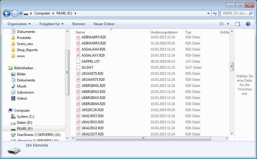

Can you post an image? I believe the most important thing is that all the files are in the root of the stick. SG.DAT is required for the shapes. Again, can you please post a picture?
For me it looks like this:

This what I got:

You need to run the installers (apsdisk55.exe and apsdisk73.exe) to extract the personality files (.R20).
