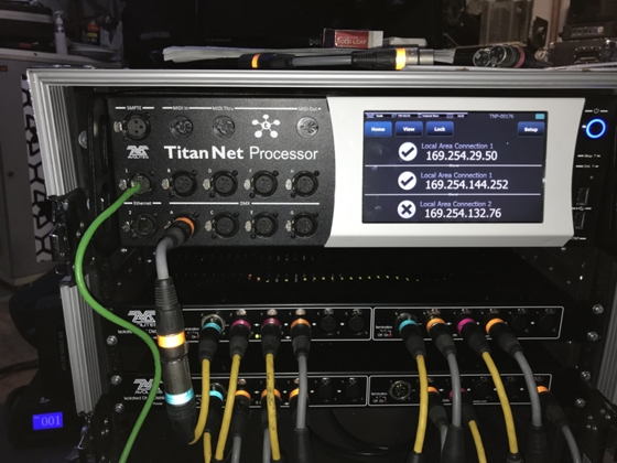

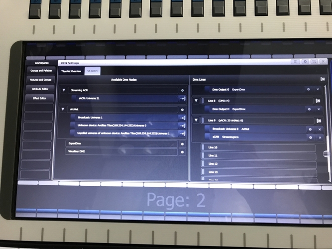

hi all , i need to patch a Titan Net Processor , i need around 20 + universe over Net Processor starting from 1 Universe to 20 + Universe , how can i configure it via IP address and make it communicate , please tell me the setting of both Sapphire and Titan Net Processor ,and what are A to H outs in Net Processor And what are 2 Ethernet Inputs for ?

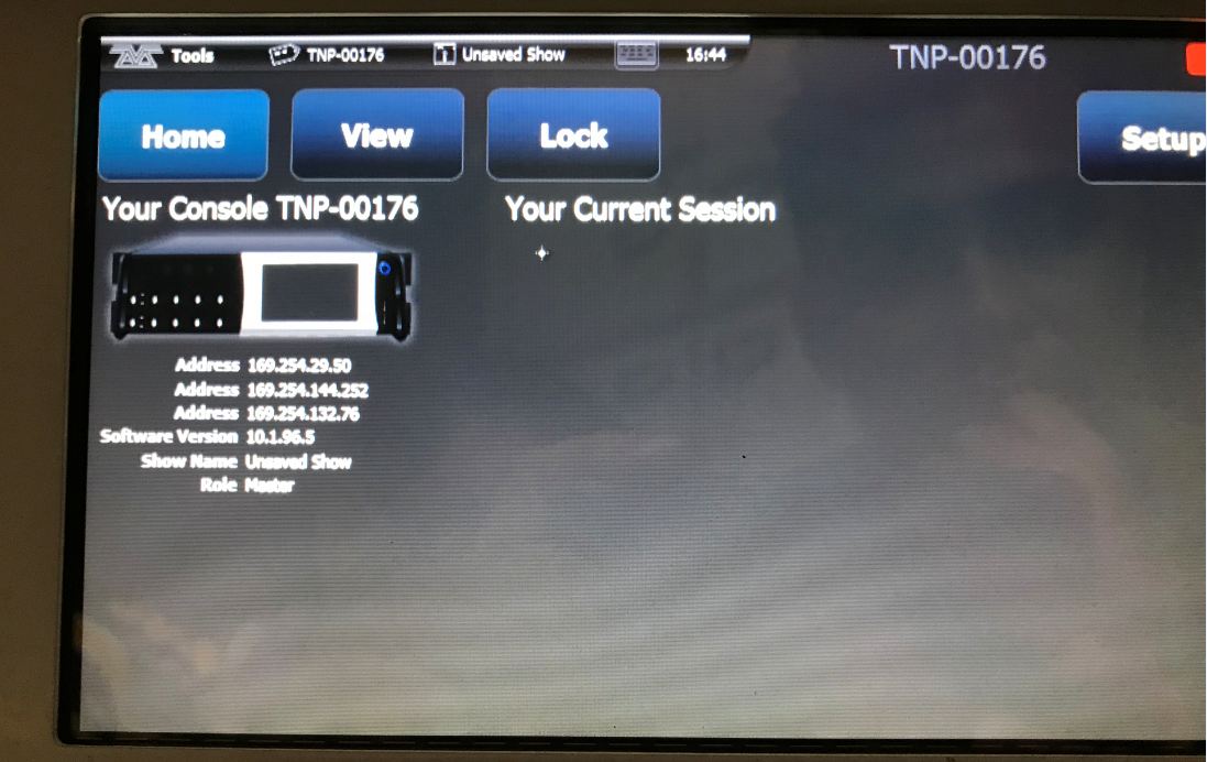

In the pictures the TNP appears to be in Console Mode which means that will act as a separate console rather than as extra processing for another console. To change this go to the Tools > Switch Software menu on the TNP, after doing this restart the Sapphire Touch and the TNP should show up in TitanNet Overview in DMX Settings.
