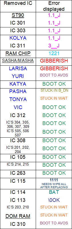

Your best course of action would be to contact Lee who handles hardware support (repairs [at] avolites.com) who will be able assist you better with your problem. A starting point would be to check that all the chips inside the console are seated correctly and have not become loose.
The only list of error codes I have is not very descriptive however if you are interested you can view it here:
