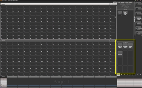

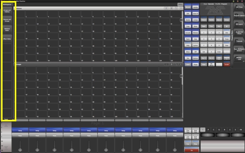

The workspace shortcut locations are currently hard coded and cannot be adjusted. The location varies depending on the console. In TitanOne and the Sapphire Touch they are arranged as a vertical column on the side of the screen. In other consoles (including the Titan Mobile) they are arranged in a 3x4 grid between the wheel display and context menu areas. As far as I am aware it has always been this way and they are predefined with 12 handles although the number displayed can reduce depending on screen resolution. As I mentioned in my previous post a separate workspace shortcut window has been proposed to provide more flexibility and hopefully this will be possible in a future version. Are you sure about the two banks/24 handles? I will attach a couple of screenshots of how it looks from a new show on my display here (1920x1200):
TitanOne
Titan Mobile
