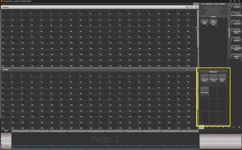

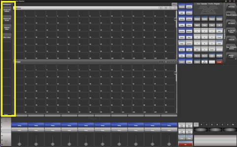

I have looked at this in a bit more detail. On my Titan One System I have a workspace window called "workspaces" which I have located on the left of my screen as a single column down the screen. This has the option of two banks of 12 handles. If I double tap any of the 24 empty handles, I can record a new workspace there. I can't remember how I set this up as it was some time ago. I have 10 handles populated.
This has not carried through to Titan Mobile and all I can see are 11 handles next to the menu buttons (I have added one which is why there are 11). Is it possible to add a workspace which contains all the workspace handles as I had in Titan One?

The workspace shortcut locations are currently hard coded and cannot be adjusted. The location varies depending on the console. In TitanOne and the Sapphire Touch they are arranged as a vertical column on the side of the screen. In other consoles (including the Titan Mobile) they are arranged in a 3x4 grid between the wheel display and context menu areas. As far as I am aware it has always been this way and they are predefined with 12 handles although the number displayed can reduce depending on screen resolution. As I mentioned in my previous post a separate workspace shortcut window has been proposed to provide more flexibility and hopefully this will be possible in a future version. Are you sure about the two banks/24 handles? I will attach a couple of screenshots of how it looks from a new show on my display here (1920x1200):watty wrote:I have looked at this in a bit more detail. On my Titan One System I have a workspace window called "workspaces" which I have located on the left of my screen as a single column down the screen. This has the option of two banks of 12 handles. If I double tap any of the 24 empty handles, I can record a new workspace there. I can't remember how I set this up as it was some time ago. I have 10 handles populated.
