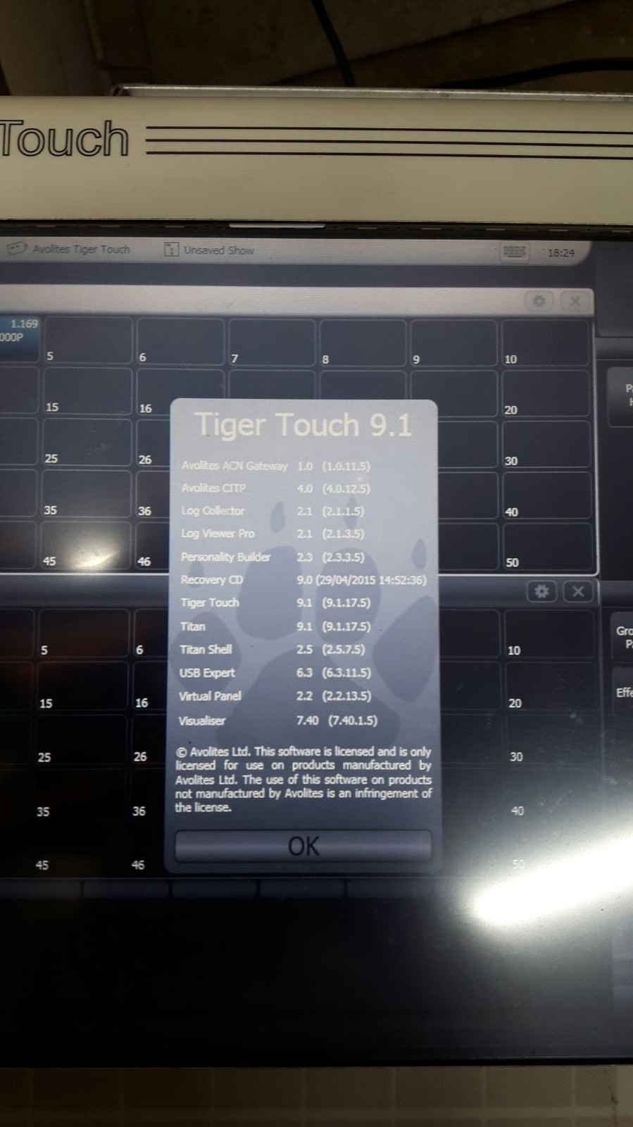

hi , i bought a TT v9 and need to upgrade it to v11 , do i need a hardware change or its simply a software change ?.

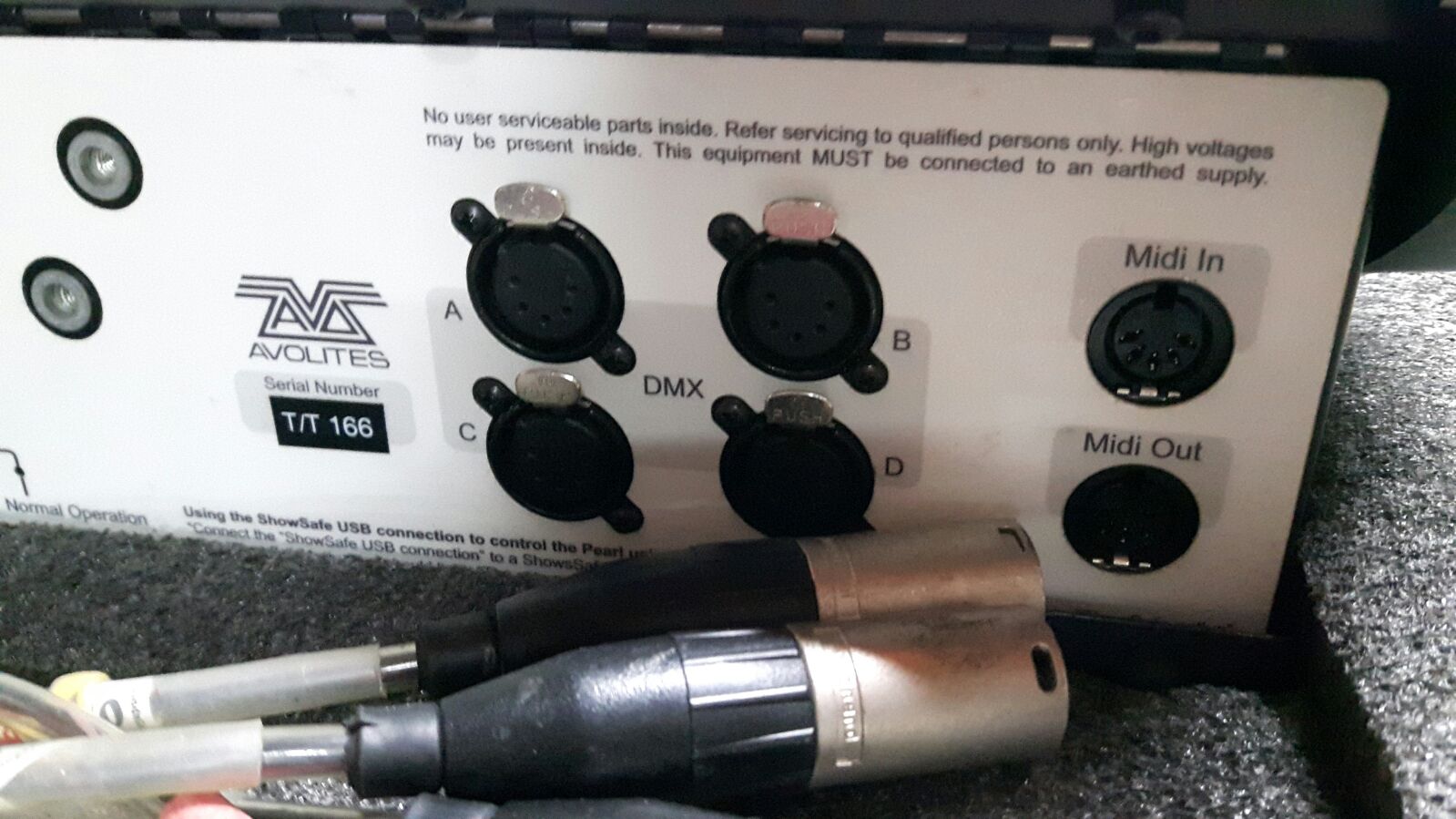

i attached the picture of my console as well .

The console will require the Pro hardware upgrade before it will be able to run version 10 and above. The full Pro upgrade includes a new motherboard, UPS, SSD and for version 10 you will also require 4GB RAM. You can check whether the motherboard has been upgraded by counting the number of Ethernet/network ports on the back as all Pro motherboards have 2.
