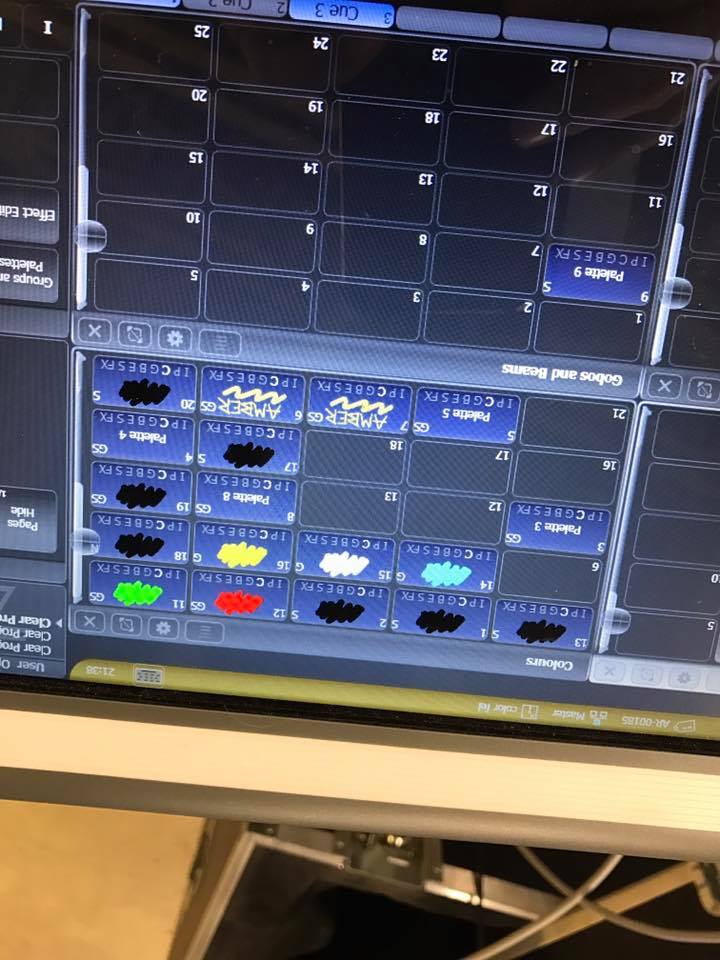

Has a small problem
When I make a color palette, the "button" becomes black !!!
It usually becomes color.
Very strange! I'm loading an old show where it worked! Tests and posts a color palette, now it becomes black

What fixture is it?
Re: Palett "bugg"
Posted: 05 May 2017, 10:51
by Nicke Löfgren
VL2000s and VL2000W
Previously, it worked perfectly with the same fixtures
Tried an old show where they worked, tested and added a new palette
Does not work in the old show
Re: Palett "bugg"
Posted: 05 May 2017, 11:01
by niclights
Unfortunately it looks like the personalities for both of these fixtures are currently missing some information which would mean auto scribble legend will fail for the fixed colour wheel. I will fix this now. However, it should work ok if you just have colour mixing in the wash.
