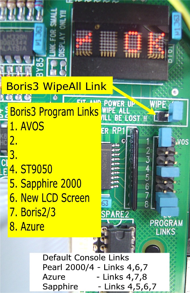

Hi Guys,
How do I reset my Pearl 2010 to Factory Settings, I cant use the menu/softkeys etc. Is there a physical button on or inside the console that will reset the console to factory settings?
Thanks,
Brad
Posts: 4465
Re: Pearl 2010 Factory Reset
Postby niclights » 08 Mar 2016, 10:32
There is a wipeall jumper inside the console. See here (Pearl 2010 has Boris 3 motherboard).
