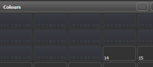

hey, i made some collor pallet's for my mac's, m800's and octo strip's,
after a reboot the color legends turned grey'ish, they still work but don't show a collor or text legend

solved it, it was a tricky one, i made these pallet's using other pallet's and then deleted the original ones whitout knowing that the new ones reffered to the old ones and not to the programmer. So they ended up referring to nothing and turned grey
