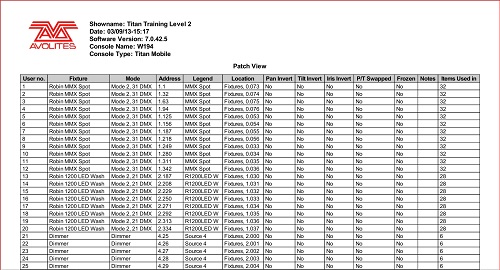

What is the best thing to use to clean the faders on a Titan Mobile? And how do you print a patch sheet? I've made a report of the fixtures but it only shows the first address... I would like to print what the patch window shows me.

Hello,
This is what your report should look like - and it's supposed to show you every fixture, ordered by user number, with every single dmx line/adress combination for each :
Are you getting something different ?

Thank you for the replies... What I do is patch house lights into one user number but in some venues they want some dimmers at different levels... my work around is to put those dimmers in different channels but I thought maybe there was a way to limit different dimmers within the same channel.
And since I put multiple dimmers in a user number the show reports only show the first dimmer.. is there a way to show all of the dimmers in the report?
