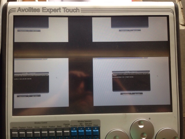

Booted up my console today at a festival show and health check showed that the time and date was off. Turns out by about 4 years - it had spontaneously set itself to sometime in 2010. This by itself shouldn't indicate any issue other than some weird time reset.
That being said, I was then prompted for activation and license code. Which, by itself is a minor inconvenience. At a festival with no internet, slightly more of an issue.
Let's compound this with my Expert Wing, which now all of a sudden looks like the attached picture. Forget about using it to run anything. It was nearly impossible just to navigate the unreadable text to scroll through to temp activation

Your BIOS battery is flat so the BIOS settings have all reset to defaults. You will need to replace the battery, apply the correct BIOS settings and run a recovery disk. You should find that your original license will still work after the recovery.

The BIOS on this console doesn't have menu options like those listed in the Upgrade Documentation. There is no option for advanced chipset functions. I can't find any method for changing the monitor to "option 7". it gives me some multiple resolutions, none of which seem to work with the touch wing. can anyone tell me the actual resolution of an Expert Touch?

Those instructions are for the original 'non pro' Experts. The pro consoles have different motherboards and BIOS.

The Pearl Expert Pro uses a different motherboard to the Pearl Expert which is why the settings are a bit different:
  • Under the Exit menu, select "Load Optimized Defaults" and press enter
  • Under the Security menu, set both the "Supervisor Password" and "User Password" to 68340
  • Enter the "Main" Menu, and set the correct "Date and Time"
  • in "Main", enter "Boot features", and set the NumLock to "Off"
  • In "Advanced" enter "System Agent (SA) Configuration" then select "Graphics Configuration" and finally select "IGD Configuration" and set as follows:
    IGD – Boot Type to LVDS
    IGD – Secondary Boot Type to CRT
    IGD – LCD Panel Type to 1280 x 800 LVDS Color Panel
    Panel Color Depth to 18 Bit.

The problem with the 0 key is due to Num Lock being enabled in the BIOS when it shouldn't be.
