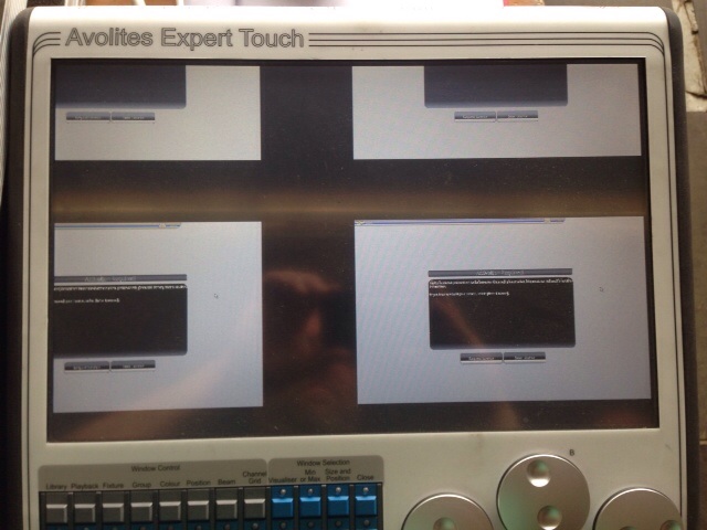

Let's compound this with my Expert Wing, which now all of a sudden looks like the attached picture. Forget about using it to run anything. It was nearly impossible just to navigate the unreadable text to scroll through to temp activation

So I finally gained access to the BIOS.
For some reason, the keyboard acts as if the function key is held down the whole time, so the 0 key wasn't returning a 0 at all. Luckily the function key lets you use keyboard as number pad, and i finally found the 0 on the M key. I haven't been able to find a setting to change that. Oddly enough, it does NOT act this way in Titan. Normal operation all the way.
So, onto the next stumbling block. We've replaced the battery, which shouldn't have been bad on a console that's 11 months old, but maybe just a faulty one.
The BIOS on this console doesn't have menu options like those listed in the Upgrade Documentation. There is no option for advanced chipset functions. I can't find any method for changing the monitor to "option 7". it gives me some multiple resolutions, none of which seem to work with the touch wing. can anyone tell me the actual resolution of an Expert Touch?
i have located some of the values under different headings, but I'm firmly believing that it has a different BIOS than it should. The attempt to reprogram the BIOS has ended in frustration. After downloading several copies of the bios boot file, extracting to multiple USB sticks to find one that would boot, it now pops up a gigantic warning screen stating that the bios file I'm trying to update with does not match the system. At this point I stopped for fear that moving forward would result in nothing good.
Now, the console will still boot into titan, but needs activation EVERY time the console boots. of course, i seems it is always a different machine id code, so the previous temp activation codes don't work. I submitted a request for another temp code, and have gotten it running. Show programmed. hoping no one shuts off the console, and i can revisit all this in Budapest tomorrow. Perhaps with better wifi.

Re: Expert Pro - Time/Date, Wing, Activation
The Pearl Expert Pro uses a different motherboard to the Pearl Expert which is why the settings are a bit different:
After you have corrected the BIOS settings please check that the settings persist by turning off the console and unplugging it for a few minutes then going back into the BIOS.
The problem with the 0 key is due to Num Lock being enabled in the BIOS when it shouldn't be.
- Under the Exit menu, select "Load Optimized Defaults" and press enter
- Under the Security menu, set both the "Supervisor Password" and "User Password" to 68340
- Enter the "Main" Menu, and set the correct "Date and Time"
- in "Main", enter "Boot features", and set the NumLock to "Off"
- In "Advanced" enter "System Agent (SA) Configuration" then select "Graphics Configuration" and finally select "IGD Configuration" and set as follows:
IGD – Boot Type to LVDS
IGD – Secondary Boot Type to CRT
IGD – LCD Panel Type to 1280 x 800 LVDS Color Panel
Panel Color Depth to 18 Bit. - Enter the "Advanced" menu, and then enter the "South Bridge Configuration" menu.
- Enter the "SB PCI Express Config" menu.
- Enter the "PCI Express Port 1" menu, and change the "ASPM" setting to "Disabled".
- Go back to the "SB PCI Express Config" menu.
- Enter the "PCI Express Port 2" menu, and change the "ASPM" setting to "Disabled".
- Enter the "Boot" Menu to change the hard disk Boot Priority Order as follows:
Set the [USB HDD] to 1
Set the [USB CD] to 2
Set the [ATA HDD0] to 3 - Disable the other devices by selecting them and pressing Shift + 1
- Enter the "Others" Menu, and then enter the "SIO Configuration" Menu.
Set the "Powerloss / Powercontrol" setting to [Always Off] - Go to the Exit menu. Select "Exit Saving Changes", press Enter, then Y, then Enter.
