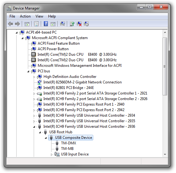

Is there any devices shown in Device Manager when the Titan Mobile is connected, for example under Unknown Devices? This may be more obvious if you change the View setting to Devices by connection and look through the devices under USB controllers, see the screenshot below:
