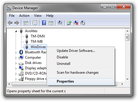

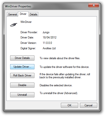

  • Expand the Avolites category, right-click on WinDriver and select Properties.
  • Image
  • In the properties window note the Driver Version, it should be 11.0.0.0 as shown below.
  • Image

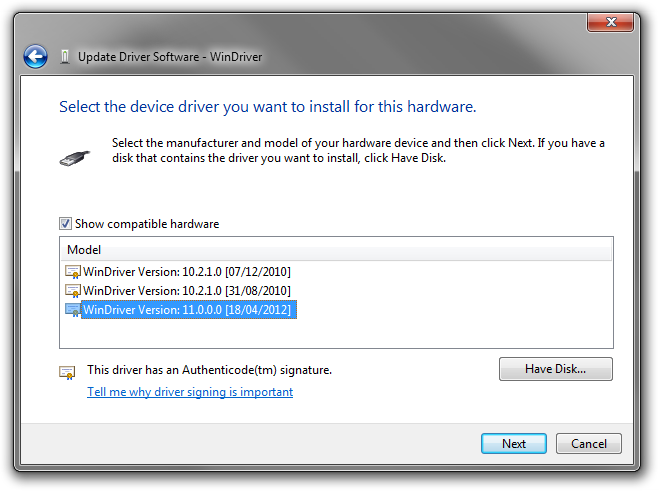

  • If not, click on the Update Driver... button, select Browse my computer for driver software then Let me pick from a list of device drivers on my computer.
  • This will show a list of the compatible drivers that are installed, please select Version: 11.0.0.0 and click Next.

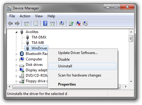

  • Please uninstall the current driver by right-clicking on the device in Device Manager and selecting Uninstall.
  • Image

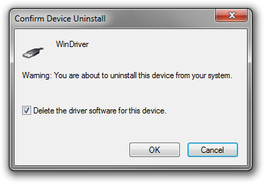

  • When prompted tick the box: Delete the driver software for this device and click OK.
  • Image
  • Repeat the uninstallation steps for any other devices under the Avolites category (e.g. TM-DMX, TM-MB).
