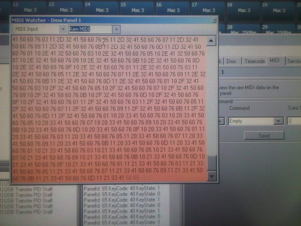

icke_siegen wrote:You may test the MIDI input:
- open USB expert console
- in the left pane, select one of the DMX panels (sorry, I don't know which one carries the MIDI in)
- in the right pane, select the MIDI tab
- select 'Watch MIDI' - hopefully you see the incoming MIDI bursts

Just have an updated , pls take a look at these pictures :
http://img.photobucket.com/albums/v402/ ... -00125.jpg
http://img.photobucket.com/albums/v402/ ... -00124.jpg
In these pictures , i think the Tiger Touch was receiving MTC from my soundcard , when i played a song in reaper , it displayed like that , and if i stopped playing , it displayed stopped receiving too . And then i follow the TT's manual 8.6.5 , it's not working when i go to midi timecode . In internal timecode i try it work perfectly , but external MTC didn't work. Any suggestion for me ?

Ah.
Looks like the desk receives something - but not timecode. Which means Reaper is sending something, but it's not timecode. If it were timecode, then you could see different values, and not always 08 00 or something alike.
I am deeply sorry, but you'd need to look at Reaper a little more. Some hints, don't know if this helps, from http://forum.cockos.com/showthread.php?t=4199
Well, this post is somewhat old (4 years), but maybe this does the trick.

Hi
Just have an update , pls look at these pic , the TT i think was receiving something diffrents , but it still didn't work .
http://img.photobucket.com/albums/v402/ ... -00128.jpg
http://img.photobucket.com/albums/v402/ ... -00127.jpg

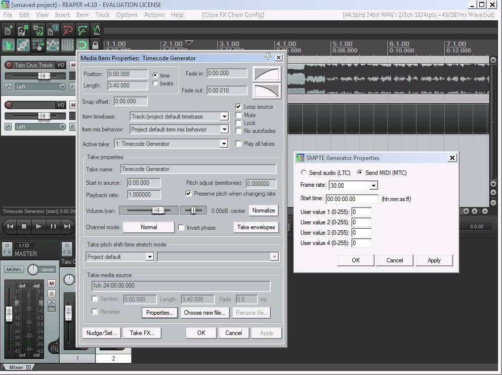

I actually downloaded and installed reaper only for testing this myself, so please dont't ask for any other details.
After fiddling with the settings for hours, I simply did like in the formerly quoted description, and it works straight away, the crucial thing were two options:
- Go to the source properties and uncheck "Send Audio LTC" and then check "Send midi (MTC)."
- Then go to that track's I/O parameters and set the "Midi Hardware Output"
my setup: Reaper 4.1.0 (latest), Edirol UA25, Tiger Touch version 4.1.9
Please have a look at the picture here
And as suspected earlier: MTC seems to be good only for full seconds - the frames jump. Maybe this can be tweaked further, but that's beyond my scope.
