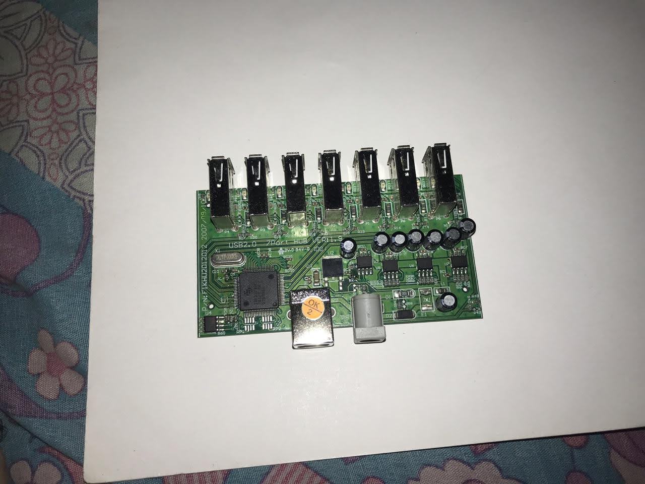

If you are telling about Playback panels, Probably, change the main USB hub situated inside or try to shuffle the main usb hub outs to find the panel working
TT main USB Hub
