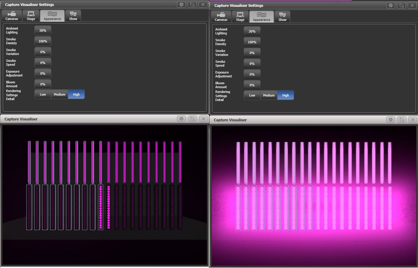

Comparison image showing V11.4 with Atlas component on the left vs V12.0 with 2018 component on the right.
  • Same show/fixtures/theatre/Capture settings/platform
  • 20x Astera TitanTubes in 1:RGB px=1,strb=OFF mode on the top and 20x American DJ Mega Tri Bars in 54 DMX, 8bit mode on the bottom.
  • I have deliberately included 20 of each arranged this way to demonstrate the sensitivity to camera location/viewing angle in Atlas compared to 2018 as well as the relative intensity. All fixtures are at the same Z position (ie. distance from camera). The left-half of each type are selected to show the difference when selected.
  • Control levels for all fixtures/types in both images are Dimmer 100%, R100%, G0%, B100%.
Note that unlike the American DJ Mega Tri Bars the Astera TitanTubes are currently set to not throw light. I suspect this is related to the fact they are a diffused type. It was something of a battle to persuade Capture to simulate them at all as they should really be omnidirectional tubes which are not currently supported so this is the better than nothing if not entirely accurate compromise.

Thanks for the pics.
Have just tried it at home, and all is good with v 13. Also discovered that the Mobile Key unlocks Simulator, so dont need the Mobile attached, even though it’s nice with hardware control surface.
