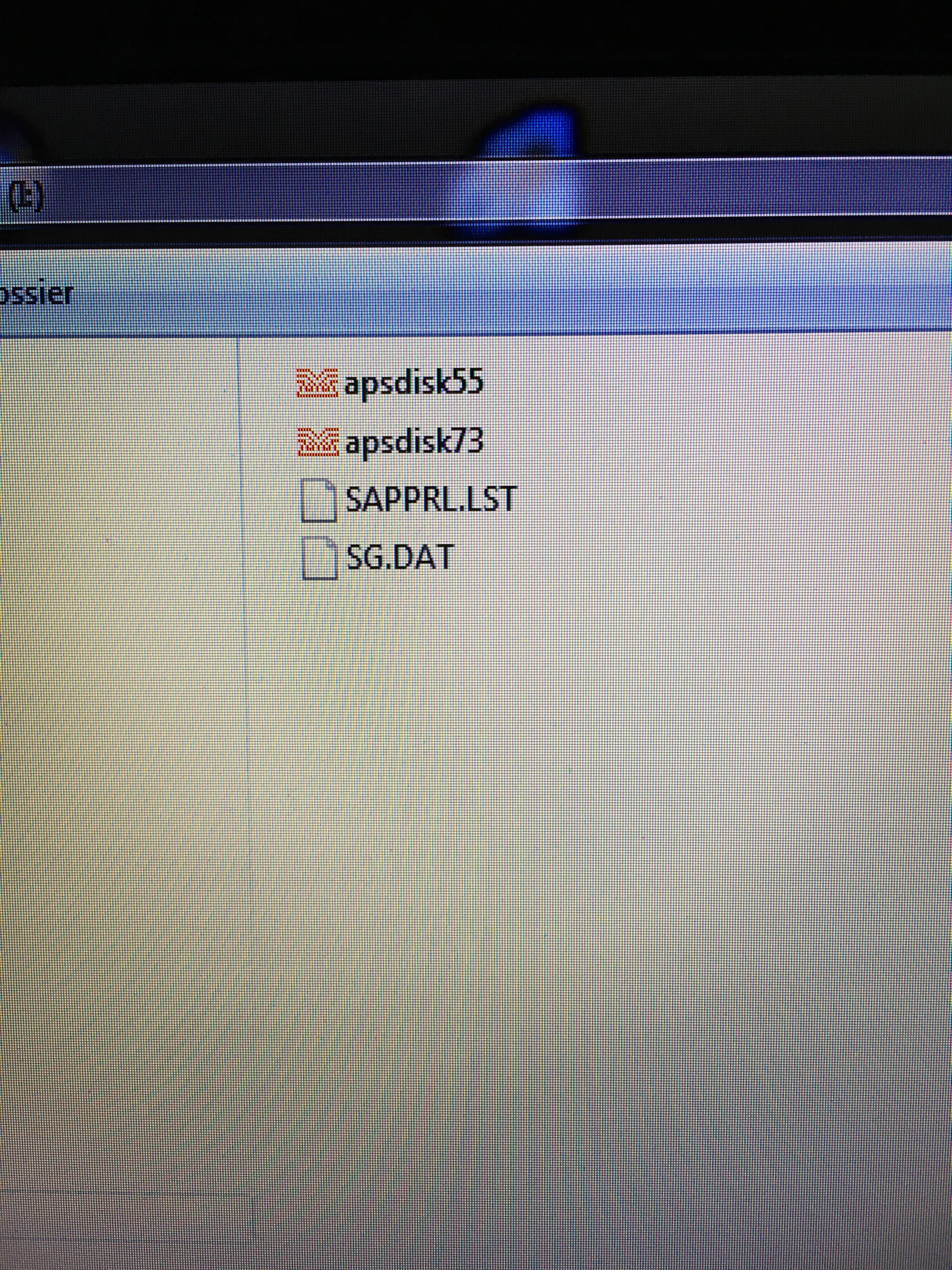

Can you post an image? I believe the most important thing is that all the files are in the root of the stick. SG.DAT is required for the shapes. Again, can you please post a picture?
For me it looks like this:

Postby Vévé » 10 Oct 2018, 19:53
This what I got:

Postby niclights » 10 Oct 2018, 20:37
You need to run the installers (apsdisk55.exe and apsdisk73.exe) to extract the personality files (.R20).

Postby Vévé » 11 Oct 2018, 17:35
Yes!!!
It works :D :D
Thank you guys for helping a newbie :lol:

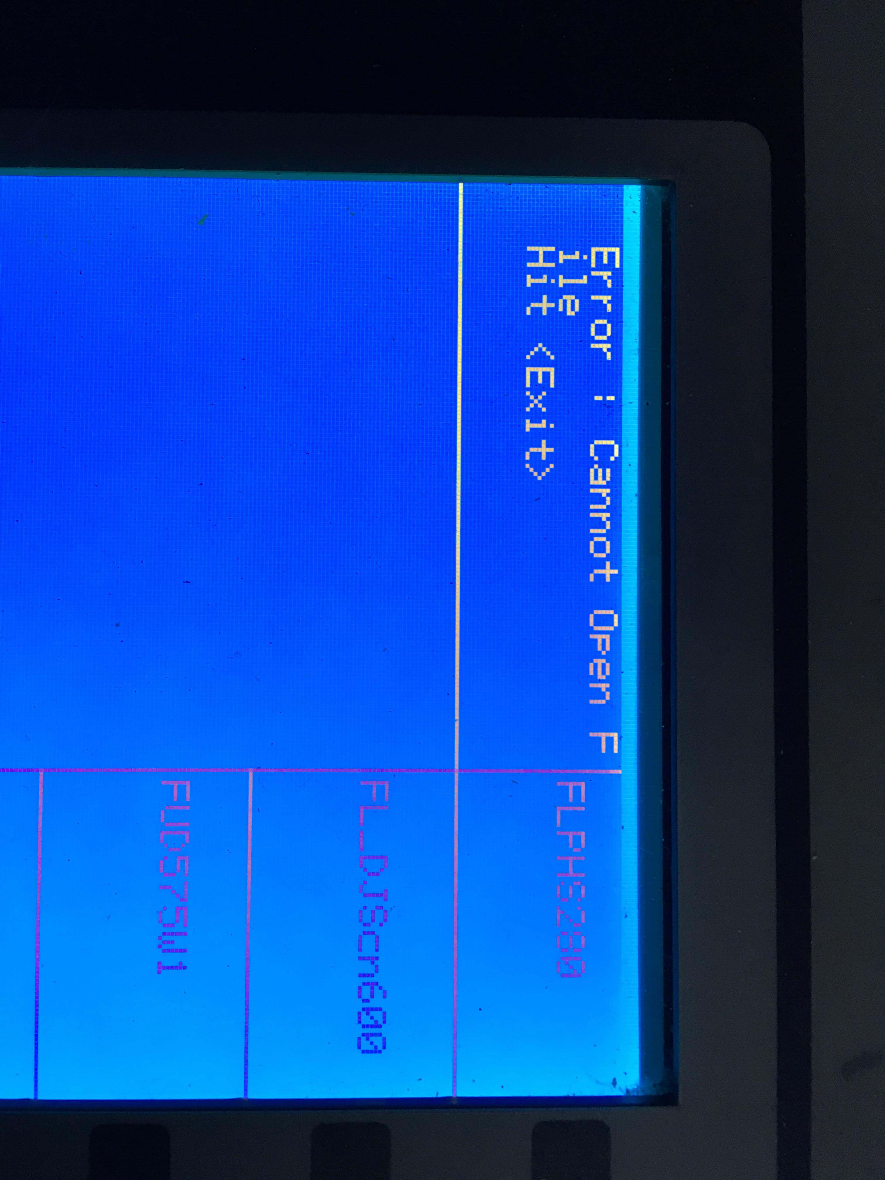

Postby Vévé » 08 Oct 2019, 09:32
It seems now that my console can’t se the usb stick. It load fixture with it’s internal memory (witch by the way I don’t Knowles How to reach.
I think it happened when I try to patch a fixture but it doesn’t work. Maybe a corrupted file :?
Will try with floppy disk to see if it works.
