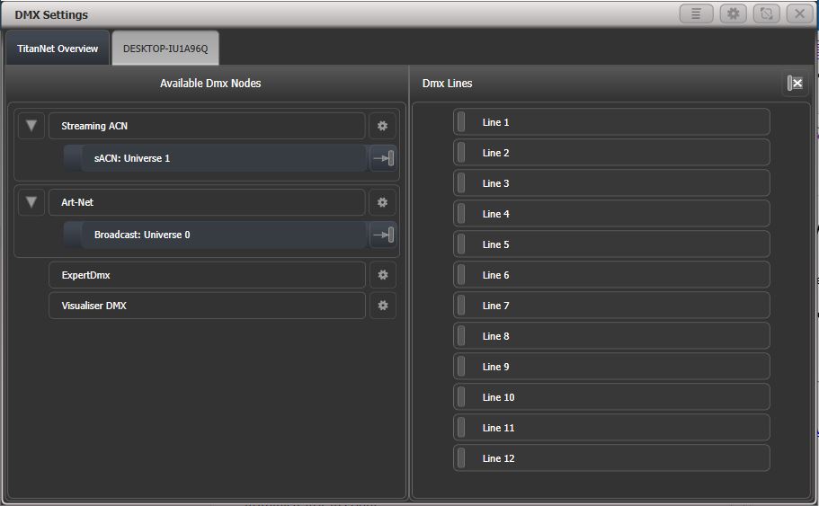

How to get back the ability to add DMXExpert As available DMX node. Ref. attachment showing current situation.
DMX Settings.JPG (53.98 KiB) Viewed 6569 times

Only available Dmx nodes will appear. It looks like you are on a PC. Do you have a Titan Mobile or TItanOne dongle connected with physical outputs? If not this is normal.

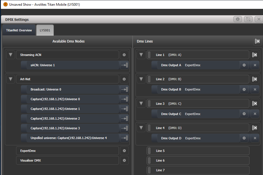

Titan Mobile is connected - ref attachment
DMX Setting Titan Mobile.PNG (61.71 KiB) Viewed 6564 times

That looks like it's a different machine (LYS001). All the outputs are assigned to lines. If you click on the 'x' next to the output under the line it will return to available DmxExpert nodes.
What is the problem? Is it that the nodes are showing when the Titan Mobile is connected to one machine (LYS001) but not when it is connected to the other (DESKTOP-IU1A96Q)?

My understanding of the situation is improved. The first screenshot was from Titan One simulator on my laptop and the second on our production machine with Titan Mobile Connected. I was som focused on the left hand pane that I did not see what you told me in your first reply. So thanks - I hav no problem with this issue now.
