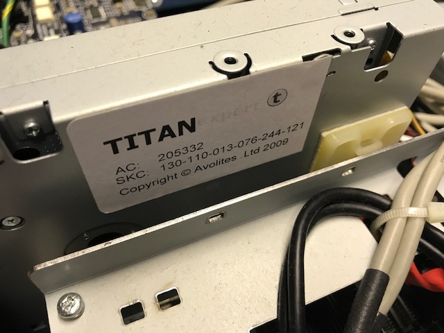

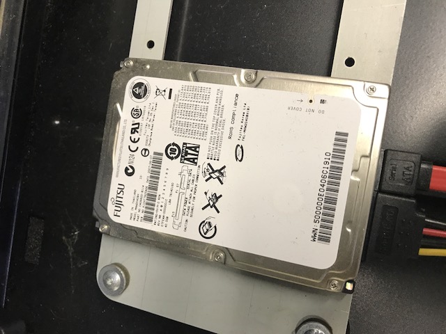

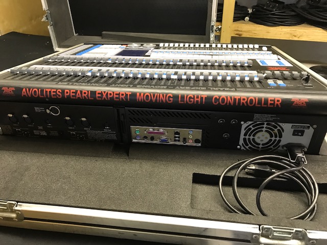

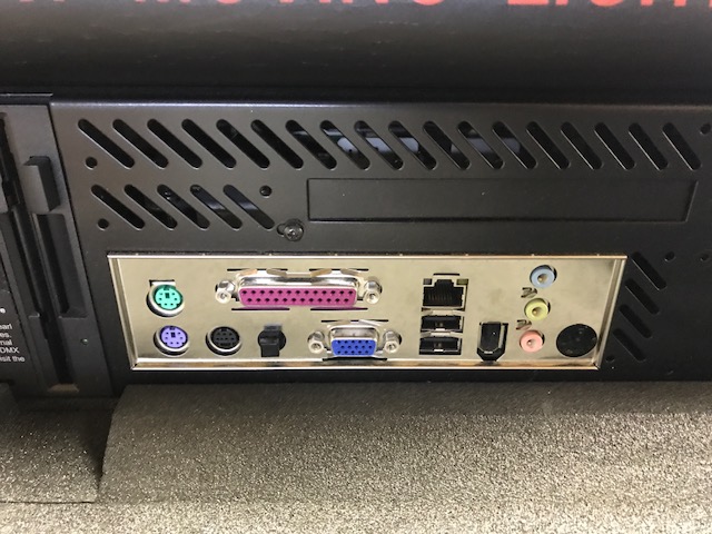

I was sooooo wrong about the console! It's black, one ethernet port, and no ssd. It appears to be running V3.1...does anyone know how much a "pro upgrade kit" is?
Console photos attached...
jasontaylormedia
Posts: 11
Joined: 18 Jul 2017, 13:35
Re: Running V10 show on older software version
Postby jasontaylormedia » 02 Aug 2017, 07:07
More photos...
Postby Gregory » 02 Aug 2017, 21:34
Probably the best option is to contact your local distributor for pricing.
Have you checked the version number installed (turning key to system or pressing Avo+Disk)? It is possible that the software on the console has been updated and the old recovery disk has been left inside.
