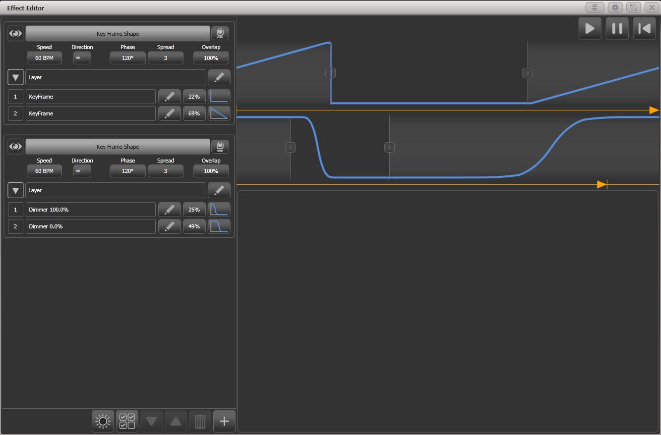

Never tried, but I think with the Key Frames Shapes it is much easier.
Make two shapes, one for the movement. From left to right and then snap back to left fast.
The second shape you create 2 cue's. First with the dimmer full open, second with the dimmer closed.
Give it a offset and play a little bit with the timing.

If you make two layers in one key frame shape they will follow the same speed and phase which might make it easier to make adjustments and not end up out of sync while you are editing them.

Exactly. The effect in the video clip looks like it has a pause on the pan and dimmer after it resets making it slightly harder with the timing. I've attached an image showing my key frame version of the effect. The first effect is the pan where frame 1 is pan on the right and frame 2 pan on the left:
