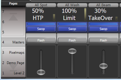

morgan free
Posts: 12
Joined: 11 Apr 2014, 09:05
Re: Group Intensity Masters
Postby morgan free » 28 Apr 2014, 15:25
assing masters and how to choose?

morgan free
Posts: 12
Postby morgan free » 30 Apr 2014, 10:33
I joined it in the picture

morgan free
Posts: 12
Postby morgan free » 30 Apr 2014, 11:55
load group on fader , blue button is swop group

Posts: 4464
Postby niclights » 30 Apr 2014, 15:22
Currently for group masters both the blue and grey keys function as select. Hopefully in the future it will be possible to change the action using key profiles but this is not possible at the moment.
Was that your question?
zeke
Posts: 11
Joined: 23 Oct 2015, 18:41
Postby zeke » 29 Jan 2016, 09:52
That is mine question.
Is it possible already to have the grey button working as a flash button for a group master (scale master).
