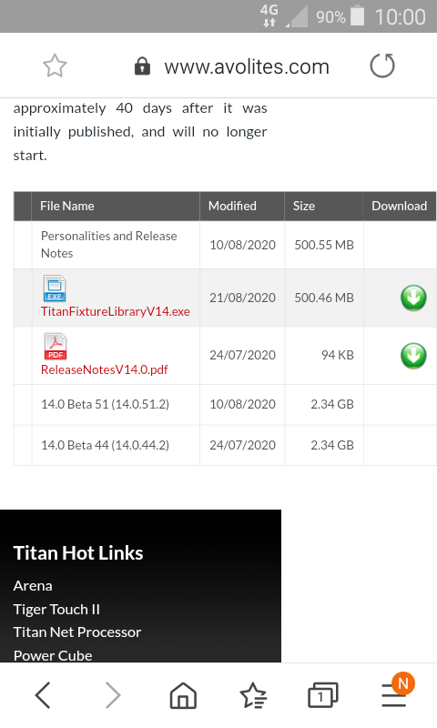

I'm not seeing that in the list of beta downloads. I've attached a screenshot from my phone to this post. Perhaps you have different user permissions set for the website so you are seeing a different list to me.
Edit; I've just realised you don't get the "more..." option on the android browser. I'll take another look with a proper pc when I get home.

Re: Unable to take control of ai. Software version mismatch.
You need to select the row for the beta to expand it to show the available downloads for that beta.
Thanks. Yes i was being thick. Got it all sorted now.
