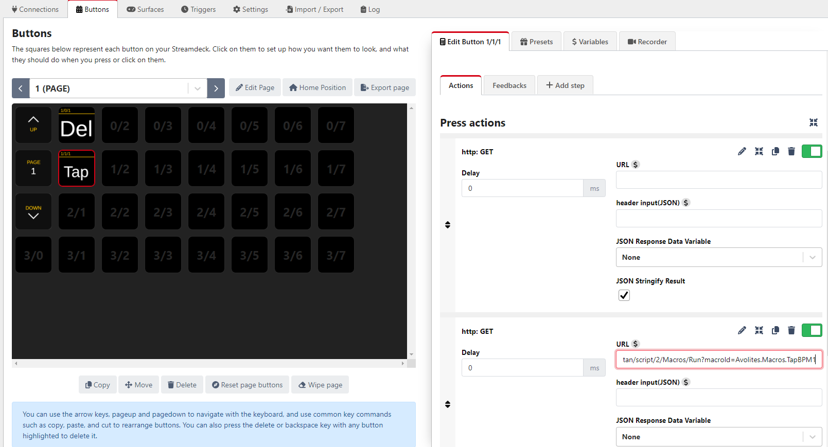

- I successfully tried this with my Streamdeck. In order to do so I used Companion with the generic http connection module (see attached screenshot). With this, you simply add the full url string including the port, and port 4431 (or any other, I suppose) is no problem.

- Attachments
- Screenshot: Companion http connection
- comp_http.png (93.2 KiB) Viewed 42922 times
