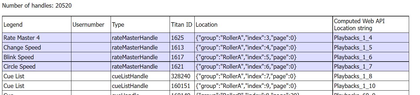

I checked the TitanID from https://www.avolites.de/downloads/midit ... tanids.htm.
Rate master 4 has been used from 14.0. The other rate masters before 14.0.
I think that cause the problem. But I can't try to fix it cause a lot of playbacks are related to these four rate masters.

And I don't know why the logs say "Unable to find handle in group 'HandleOptions.Playbacks' with index '1613'.".
As you can see, there is 1613 Titanid in the picture.
I sent you the logs, thank you.

Hm, I don't really know. I would at least try to select the master by location.
Re: How to assign rate master to a chase?
Posted: 27 Dec 2021, 08:54
by kimwida
Haha, you're right!!!
It works now!!! Thank you!!!
