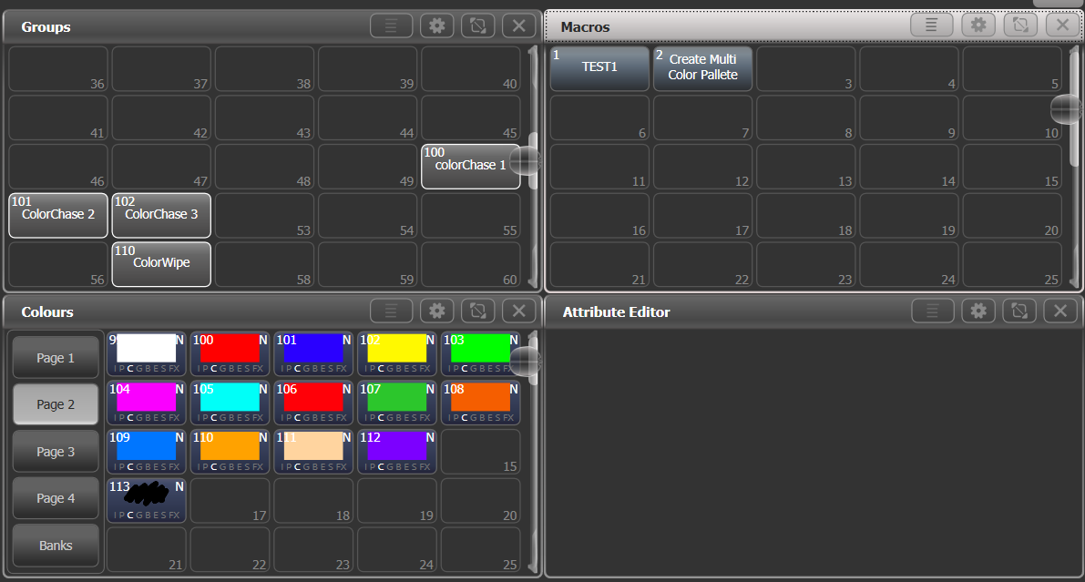

What (I think) it should do: select first group, apply blue colour palette. Select second group, apply blue palette. Select third group, apply red palette. Select all three groups and then it should store the created palette into the colour window workspace (replace palette with user number 113).
My question: When I try to run this macro, I can see the first group of fixtures is selected but no color information is in the programmer, so I assume the macro stops after the first step, but why?
All groups and palette information used, should be correct. (In the attachments is a screen shot of the titan interface, so you can verify the group/colour usernumbers)

Your macro tries to reference to the actual location of the handle. In this case that would be page 2/handle 2 for your red palette
Code: Select all
Palette.ApplyPalette("Location=Colours,2,2", false)</step>
If you want to refer to user numbers you can use
Code: Select all
Palette.ApplyPalette("paletteHandleUN=100", false)
In theory you shouldn't have to reselect all the groups as the information is in the programmer anyways.

Thanks for your reply, tried it out and the macro runs and records a palette. However, when I recall the palette it turns all fixtures (all 3 groups) red, what could cause this?

I checked the content of the palette, it contains only the fixturs of the first group (usernumber 100). Color information is red.
