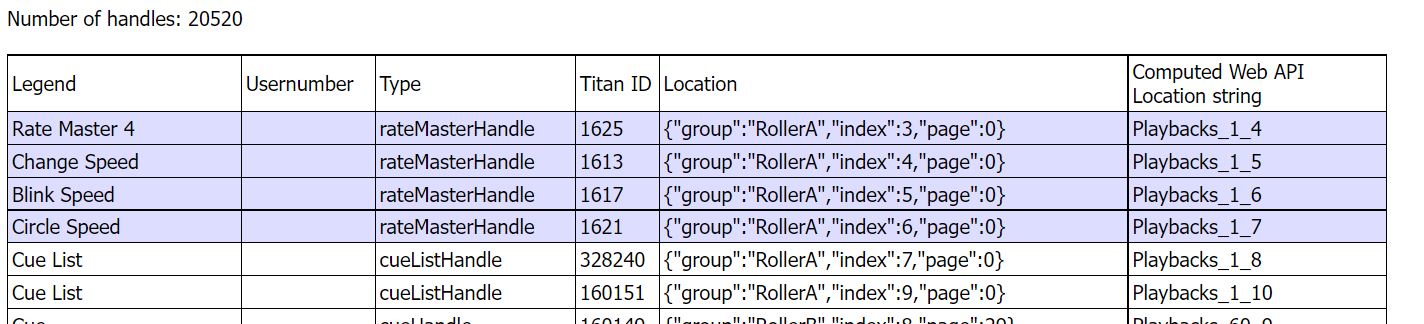

I've been using my show file from 11.0 to 14.0. It's very old and big.
I checked the TitanID from https://www.avolites.de/downloads/midit ... tanids.htm.
Rate master 4 has been used from 14.0. The other rate masters before 14.0.
I think that cause the problem. But I can't try to fix it cause a lot of playbacks are related to these four rate masters.
Code: Select all
    <sequence>
       <step pause="0.05">Handles.SetSourceHandleFromHandle("chaseHandleUN=13424") </step>
       <step pause="0.05">Handles.FilterHandleOptions()</step>
       <step pause="0.05">HandleOptions.Playbacks.AssignSpeedSourceFromHandle(1613)</step>
       <step pause="0.05">Handles.ClearSelection()</step>
       <step pause="0.05">Handles.ClearHandleOptionsFilter()</step>
    </sequence>
And I don't know why the logs say "Unable to find handle in group 'HandleOptions.Playbacks' with index '1613'.".
As you can see, there is 1613 Titanid in the picture.
I sent you the logs, thank you.

Postby icke_siegen » 27 Dec 2021, 06:36
Hm, I don't really know. I would at least try to select the master by location.
kimwida
Posts: 267
Joined: 05 Aug 2016, 16:26
Location: Seoul
Re: How to assign rate master to a chase?
Postby kimwida » 27 Dec 2021, 08:54
Haha, you're right!!!
It works now!!! Thank you!!!
