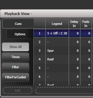

1. Record a playback in first slot of second playbacks window page.
2. Set On "Column Filters Visible" in Playback View.
3. Edit Columns and save it.
4. Select a filter.
5. Run the macro.

6. You see the filter id on first playback of second playbacks window page.
7. Run the macro for the filter. 70687 is the selected filter id.
