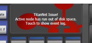

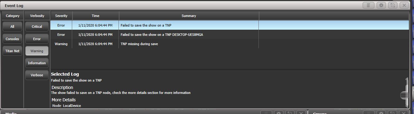

I am using two V12.1 T1s. One for my home, the other for my club.
Usually, I program it at home and upload it to my cloud. Then I download it and use it for my club show.
I don't have any error to save show file in my home but in my club I can't save show file and it shows these errors.
error 1.JPG (58.26 KiB) Viewed 5061 times
error 3.JPG (69.37 KiB) Viewed 5060 times
I don't have any TNP.
I found my workaround. Active autosave and wait until it save a autosave file. And then I can save show file without errors.
Could I fix it??
