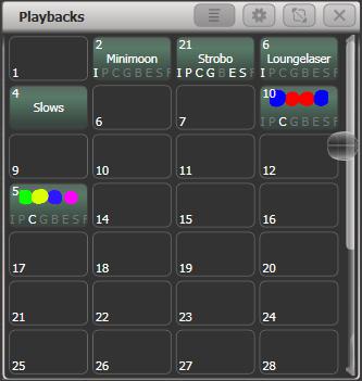

The terminology confuses me.
Please correct me if I'm wrong:
A handle is a virtual fader (below in the software)
A pallette is something like this:
Print40creen 2018-02-20 12.30.40.jpg (17.38 KiB) Viewed 24180 times
So I want different functions (Swop / Latch / Flash) for different buttons in for example the playback palette.
Is this possible. I know it's possible for handles but is is also possible to set it for each button individually?
Let's say 'Slows' works as Latch while 'Strobo' works as Flash

Those are playbacks (exactly the same as the playback faders but without the fader).
You can set button actions specific to playbacks by defining the action in a key profile (for example key profile 1 = cue->touch->flash and key profile 2 = cue->touch>latch) and then assign the required key profile to the playback in playback options.
The key profile concept is very powerful in that it allows you to quickly change the button actions across many playbacks live (for example all your chases could be tap tempo on the blue key and then you could switch them all to be swop). But it is recognised that when you just want to set the action for an individual playback this can seem like an unnecessary amount of work and is less intuitive. Hopefully it will be possible to make this easier in the future.
