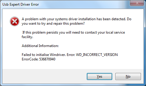

What is the error message that comes up with USB Expert? Is it the one below?

No, The error say "failed to start USB Expert Service!"
