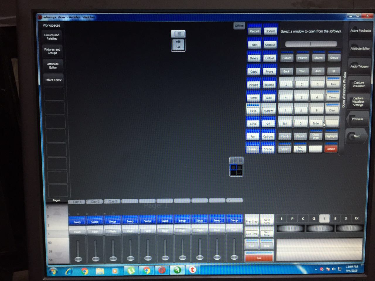

Hi all, I accidentally adjust the capture visualiser and capture visualiser setting at their minimum look , even I cannot get the tab button of adjustment in it , how to retrieve these windows to its mean positions

With the window active (white title bar) press the View button the select softkey C Window Options and then again softkey C Size and Position. This should resize the window back to one of the standard quarter positions.
