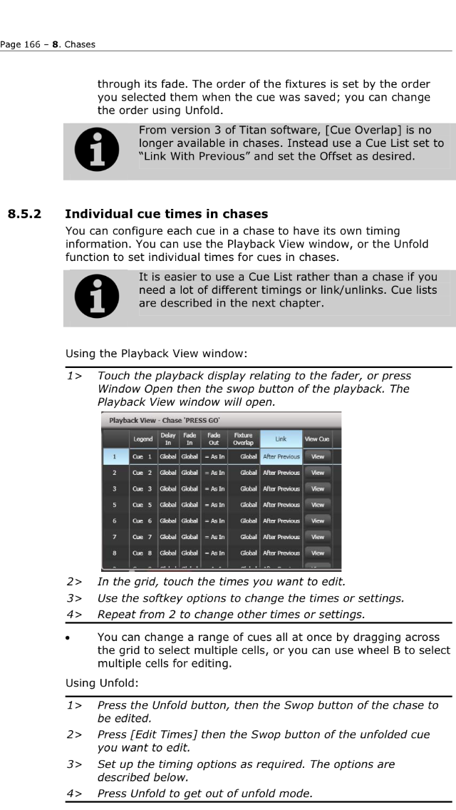

After reading some manual I see fixture overlap was removed from chases. Not sure how to proceed. Can I make a cue with overlap then add more cues and make into a chase. Will the overlap carry through to the other cues?

I'm not sure what you are reading or why you think that but Fixture Overlap is available in chases. [Edit Times]/<select chase playback>

Titan mobile manual p166

Cue Overlap is a separate function to Fixture Overlap the former was replaced by the more powerful Link Offset in cue lists the latter is still available for both chases and cue lists.

Oh thanks. This is a bit of a learning curve from light jockey
