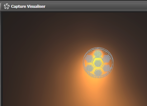

I am Building a new personality for a new fixture. It looks like the Portman P1, with 7 sections and 28 channels
https://portmanlights.com/luminaires/p1-mini-led/
Channel 1: dimmer halogen lamp section 1
Channel 2: dimmer halogen lamp section 2
Channel 3: dimmer halogen lamp section 3
Channel 4: dimmer halogen lamp section 4
Channel 5: dimmer halogen lamp section 5
Channel 6: dimmer halogen lamp section 6
Channel 7: dimmer halogen lamp section 7
Channel 8 - 10: RGB section 1
Channel 11 - 13: RGB section 2
Etc etc.
The building does go well, nut 1 have 2 problems with the shape generator:
1: dimming halogen lamp only works in channel 1 (section 1)
2: color chases, like rainbow random only works with section 2 till 7, section 1 does not working
I hope anyone can tell me what I do wrong.
Thanks a lot!
Wesley
