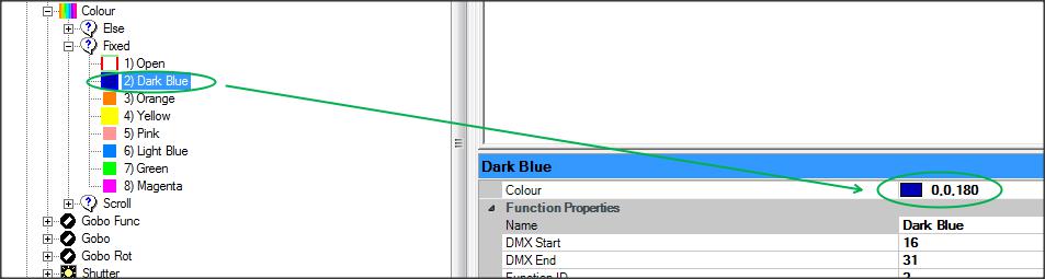

I understand what you mean but by default it's not possible to add a split color in the color section:
The Eurolite TSL-200 has 1 color wheel and by changing the DMX adress, I'm able to have a split color (red = 32 / red-yellow = 42 / yellow = 48)
If I create it as an attribute under colors, I can give it a split name 'red-yellow' but how will it be displayed in the visualiser?

Re: How to create double fixed color as color attribute?
The swatch in the colour that you have highlighted is used when creating auto palette legends, as part of the logic that determines best match when exchanging fixtures and for determining which functions to use when using the auto palette function within Personality Builder (preset palettes). There is currently no way to define a split colour for auto palette legends but perhaps it might be possible in the future.
