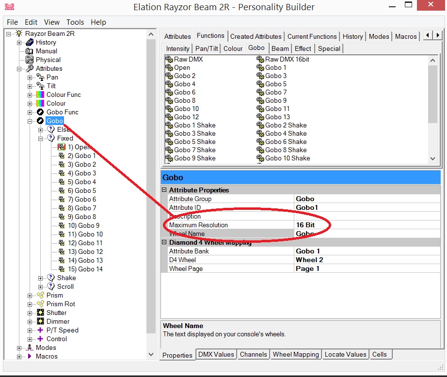

Also, to be able to specify correct values in your custom personality file, you must click on your Gobo attribute and change maximum resolution to 16-bit :
(Click on image to see the whole window)
