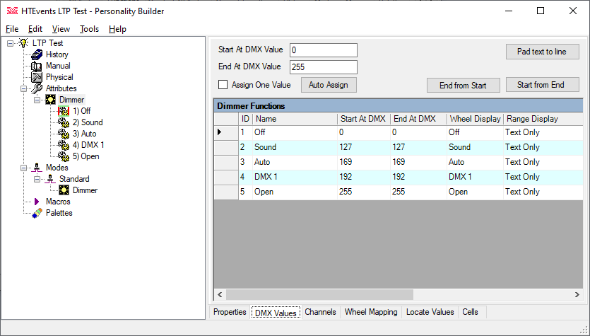

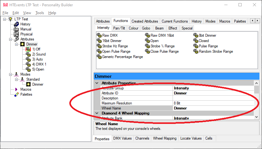

Re: Ltp attribute clear to zero
I believe the major thing is the Attribute ID.
I did a quick 'test fixture' with only one attribute: name and ID are 'Dimmer', and it contains five text values as you described:
If I do something with this fixture and the press clear (provided that I don't have a playback with another value) this channel returns to 0.
