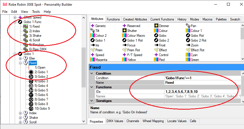

Assuming you are talking about Titan personalities: yes that's well possible. Actually it is rather standard for many spot fixtures where gobos function likewise. You have to create conditions and probably need to set the Update property so that if one channel changes the display of the other is updated. I'd recommend to open one of the existing spot fixture personalities and have a look.

Can I make the control channel linked to the intensity attribute, but have the patterns under gobo attribute? If yes, where do I make the conditions?

Re: Different attributes depending on DMX mode laser
There are many. Let's take the Robe Robin 300E Spot: here, another 'virtual' attribute is used: e.g. Gobo 1 Func, where you select between Fixed, Index, Shake etc. Depending from this there are different ranges in the actual Gobo 1 attribute:
While Nic is certainly much more fluent in explaining this I would offer, if you'd post or send the DMX table of this fixture, to help, implement and explain this with your real example.
